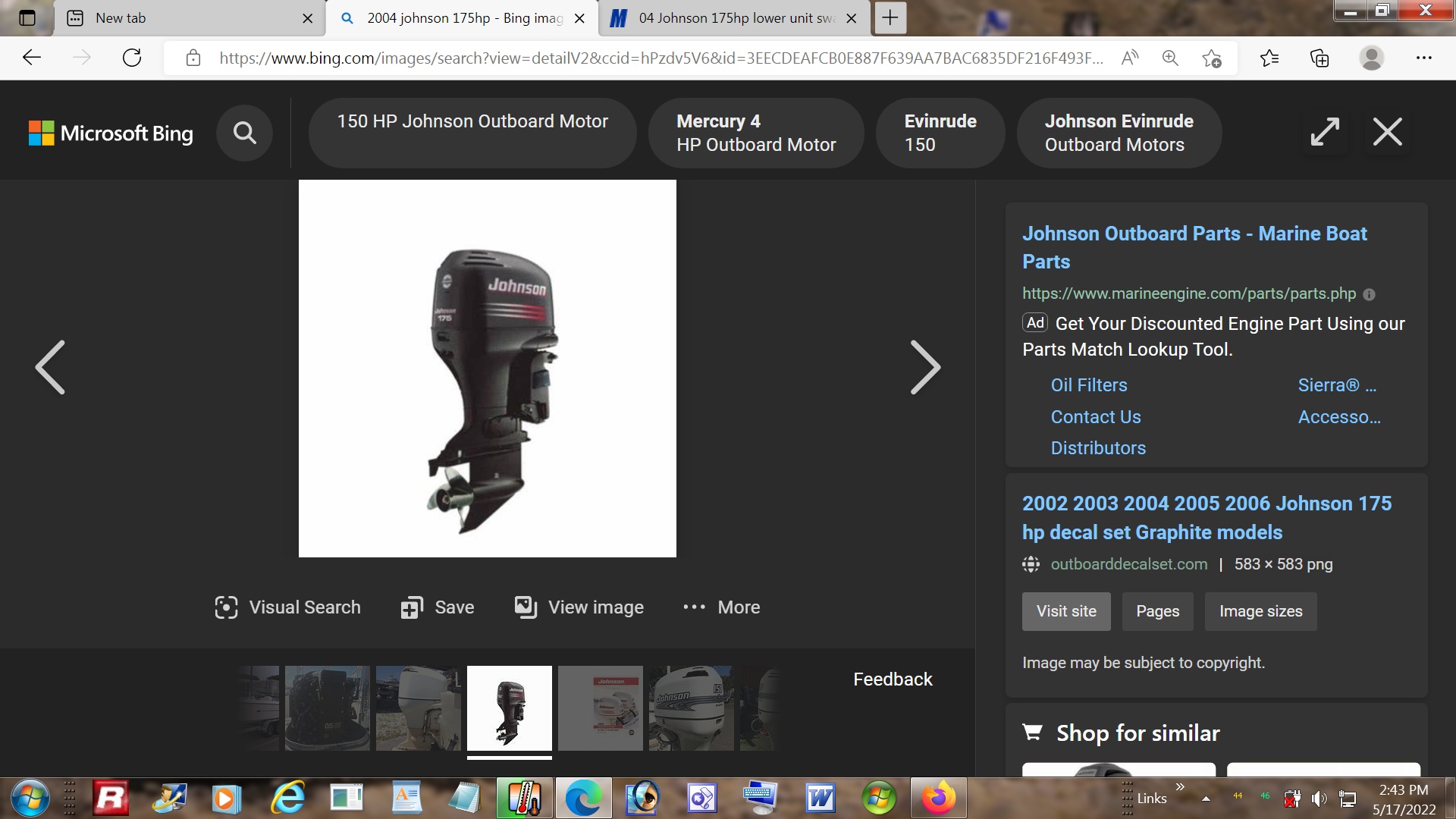

the image I post pictured left I believe is a fitch engine and it appears the same.

my first image above is a 01 which I assume must be the last of the fitch.
I see the decals for the 02-06 so I assume there all carbed. looper engines. I believe evinrude was sold to BRP and they restyled the 07 model.
