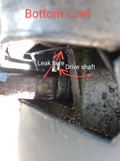

I cleaned the whole engine compartment today, and Carbs are recently rebuilt , fuel is not dripping from them. Engine compartment was clean after running on hose, I found the fuel is coming from under the the motor somewhere near where the driveshaft enters the block, might it be bottom block gasket ? IMG_20210525_170932168.jpg ?IMG_20210526_155401736_3.jpg
Follow the path of fuel delivery once inside cowling.....filter -> pump -> carbs. The leak has to be coming from one of these components or the hose connections. Check the carb bowl screws to ensure tight. Check fuel filter cap is screwed on tight. Squeeze primer bulb while eyeballing for leak.
