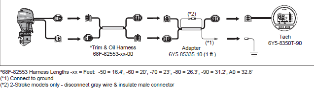

Does your tachometer have one four pin nylon connector plus four single wires? I think it does. If so, it will need an adapter harness.

GOOD MORNING. As the diagram describes it, I understand that on one side of the outboard we kept the orange, black, green/red, green/white. and we isolate the gray. I would like to point out to you the following goodies to the outboard. And explain to you where each one of them goes. Black, orange, pink are in the trim. don't know/maybe lighting coil, tacho signal) come from oil pump control unit/emergency
switch. And finally, the gray that you told me to isolate comes from the body of the cylinders, one switch on the left and one on the right (Probably two temperature switches). where is the connection in the drawing, we kept green/red, green/white. and orange/black , these two come from the trim, if only the gray that goes to the cylinder temperature switches is not a problem. I apologize for the English but it is from a google translation. Thank you for your time. Regarts
BLACK/ORANGE/PINK THESE THREE COME FROM THE TRIM, GRAY FROM THE CYLINDER BODY SENSORS, GREEN/WHITE AND GREEN/RED FROM OIL CONTROL UNIT.
IT WOULD BE EASY IF I KNEW THE TACHOMETER 6Υ5 - 8350Τ-90 WIRE COLOR MATCH I.E. WHAT THE PINK, GRAY, GREEN/RED, AND GREEN/WHITE READ

Is that a V4 two stroke 115 model or an F115 4 stroke model? What is the engine ID? Begins with the numeral 6.
good evening it is a two stroke outboard motor YAMAHA CETO V4 115 2 STROKE
