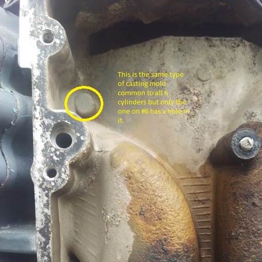

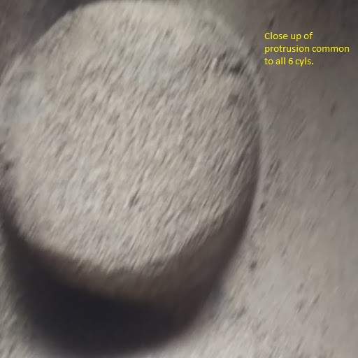

Yes the engine is reaching N.O.T. I didn't do a leak down because the compression was 128 PSI which was +/- 3 PSI of all other cyls. I did inspect the head visually for cracks or holes and requested the machine shop check it for the same they said it was good. I pulled the exhaust cover and inspected the water passage and exhaust for indications of a crack or pin hole, nothing out of the ordinary found with one exception. There are 6 round mounds with flat tops and they are a little smaller dia. than a dime. They are molded into the casting and the only one that has a hole in it is the one on #6 cylinder. I don't know if that is by design and normal or if it is a result of corrosion. I have never noticed it before but I have not chased a problem like this before. I have attached picture #2.jpg#3.jpgYamaha water jacket.jpg to help identify what I am referring to.
Did the leak check with soapy water and detected no leaks. So, I have eliminated the head, head gasket, cylinder sleeve, and exhaust/water jacket as a source of water intrusion. I guess the next step is pulling the power head to check out the casing and exhaust manifold gaskets and the crankshaft seal. A leak in the manifold or casing gaskets should affect more than just #6 cylinder I would think. However a lower crank case seal would more than likely just show up on #6 so I'm laying odds that I may have a bad lower crank shaft seal however the motor doesn't seem like it sits low enough in the water to expose the lower seal to water.
