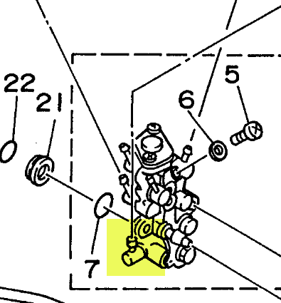

I have a 1999 P175TLRX outboard. When i backed into driveway yesterday with the boat, i noticed engine oil running down the stern of the boat. After lifting the engine cowling, i found the vertical oil line running from the engine mounted oil reservoir to the oil pump assembly had disconnected. The oil line was still attached to a 90 degree brass fitting which had disconnected from the oil pump, not the line. The brass fitting does not appear to have threads that are used to attached to the oil pump. Does anyone know if the brass fitting screws into the oil pump assembly? I am trying to figure out how to reattach it.
