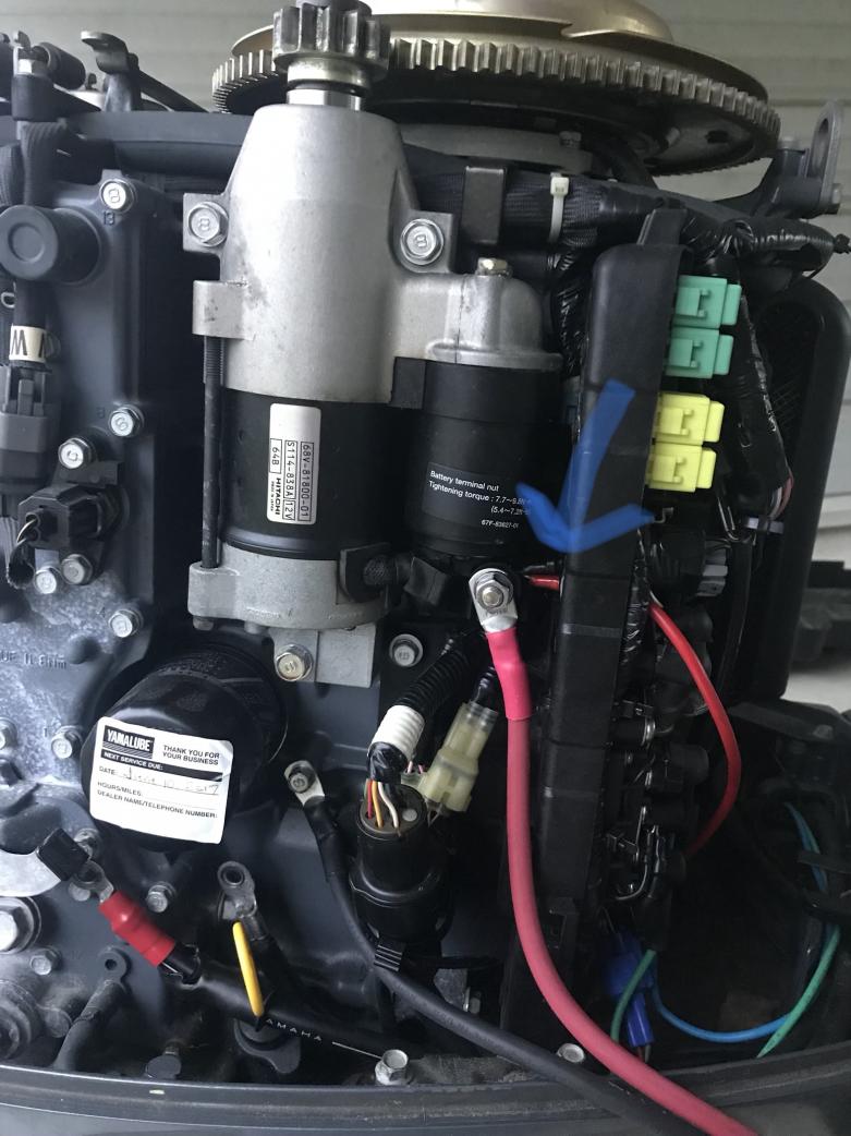

When you measured 4.5 volts when the key was in the start position what side of the solenoid were you on?
Although the diagram shows the battery cable outboard of the other three red wires i would position it to be right up against the solenoid terminal.
I had the red wire from voltmeter where the arrow is pointing, Where the red and black wires meet on solenoid and then the black wire from voltmeter on the ground.

Check the voltage on the other side of the solenoid. The terminal that goes to the starter motor. It is possible that the solenoid is causing the voltage drop. Could be the contacts within the solenoid that are causing the problem.
