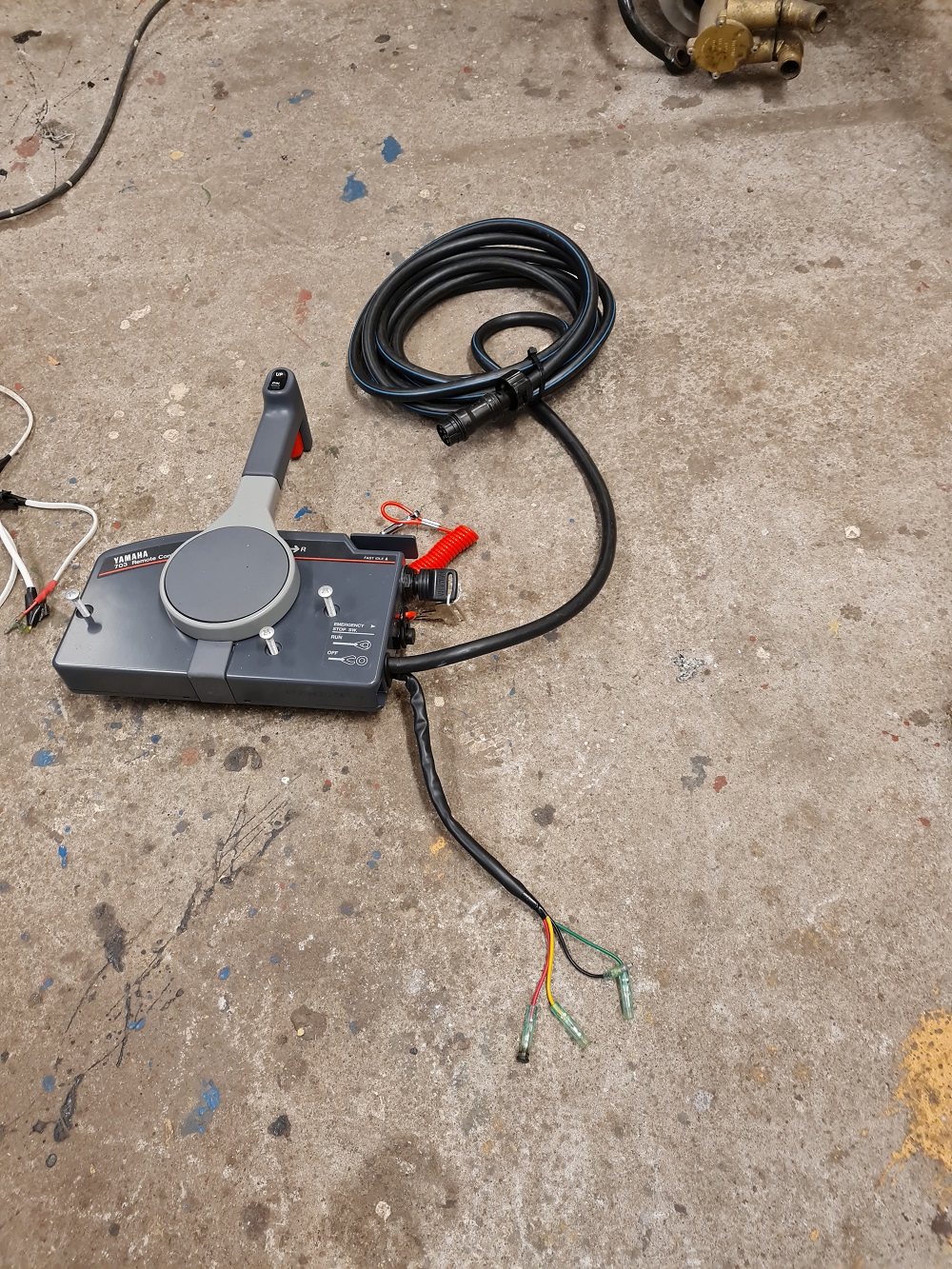

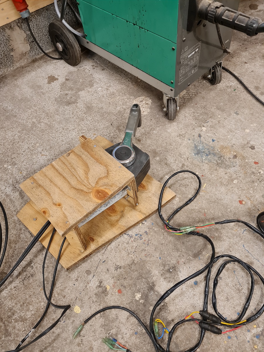

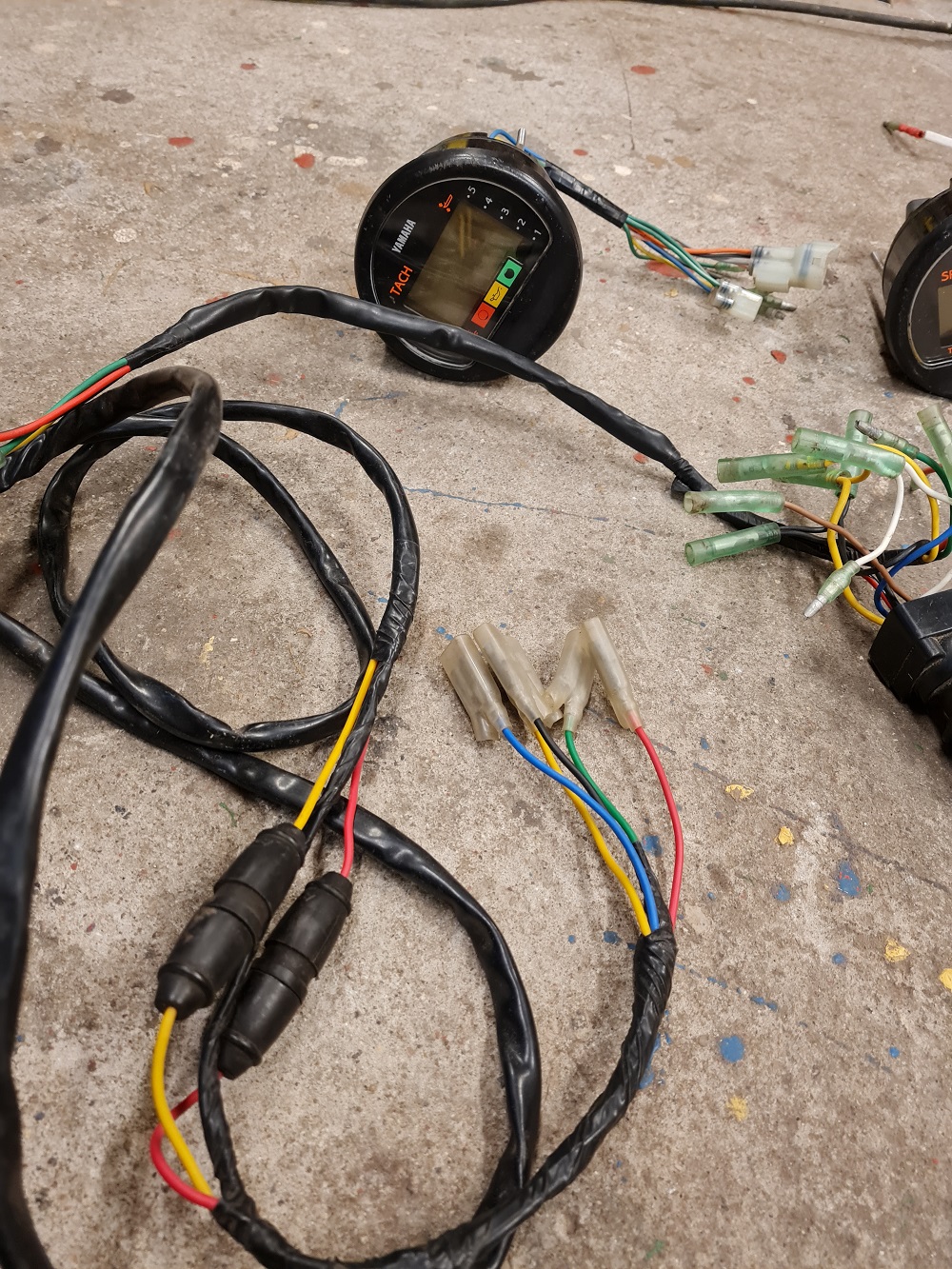

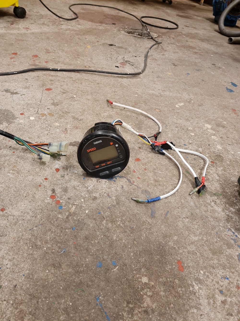

Thank you boscoe for your answer, still confused since there is much more cables from 704 vs 703? See my bad pictures.. 20210506_200215.jpg20210506_200235.jpg20210506_200246.jpg20210506_200246.jpg20210506_200259.jpg20210506_200329.jpg20210506_200354.jpg
Just a different ten pin harness is all.
704 uses one with two connectors at one end. Plus a key switch panel.
703 uses one with a connector at one end and bullet connectors at the other. The bullet connectors should be within the control box.
All else is the same.

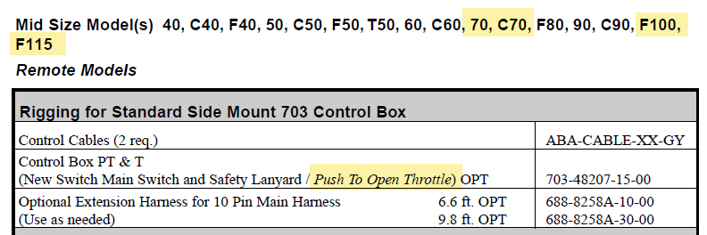

The old 70 2stroke opens throttle differently than a new 70 4stroke. One was push to open for the cable, one was pull to open. Yamaha does sell the linkage to convert the internals to change if necessary
From my recollection all 703 control boxes used with larger HP models were of a push to open pull to close type of configuration.
When I repowered my 15' Whaler from a 1993 70 to a 2023 70 I know I bought a new remote locally because I did not want to wait for the conversion kit (plus it's was showing it age)
