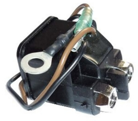

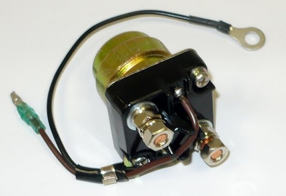

Are you familiar with Yamaha outboard motors?
At any rate, you should still have continuity between the two posts with the nuts when power is supplied to the two wires. assuming black is ground, the brown would be power. It still functions the same.
