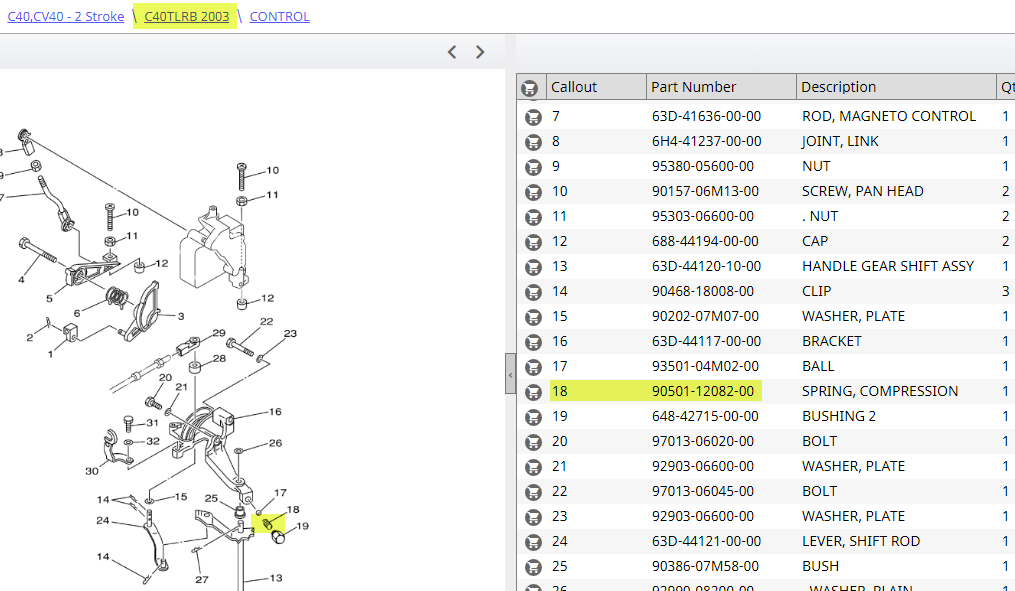

It is shown as being used in the shift shaft support mechanism. Not all models but in some C40's. It is the only spring in a Yamaha that comes close to looking like that which you found.

Guess it would be hard to imagine how a spring from that location would end up in the water path. It also doesn't appear to be similar in shape although it's hard to tell from the diagram. One thing for certain tho my spring is not a compression spring as indicated by the parts description. I appreciate you spending the time trying to come up what it could be but I don't think that's it. Thx
