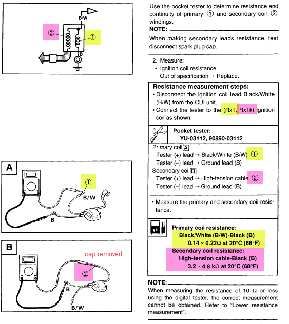

Good idea. But does sproutdreamer have a DVA meter? I am often uneasy diagnosing a capacitor discharge "brain box", by it's discharge. Much better to test other units like trigger, stator, and final coil....then point finger at the "box".
