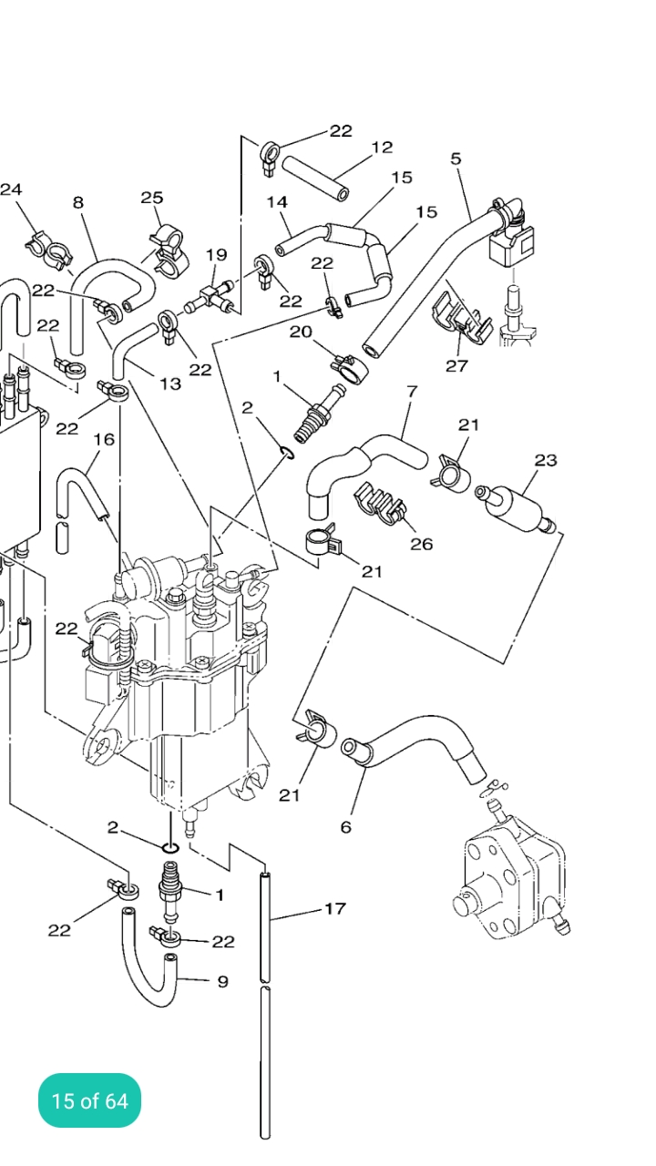

My friend are you check fuel filter (23 no parts) Screenshot_20210904-092741_MEGA.jpgScreenshot_20210904-092741_MEGA.jpg
