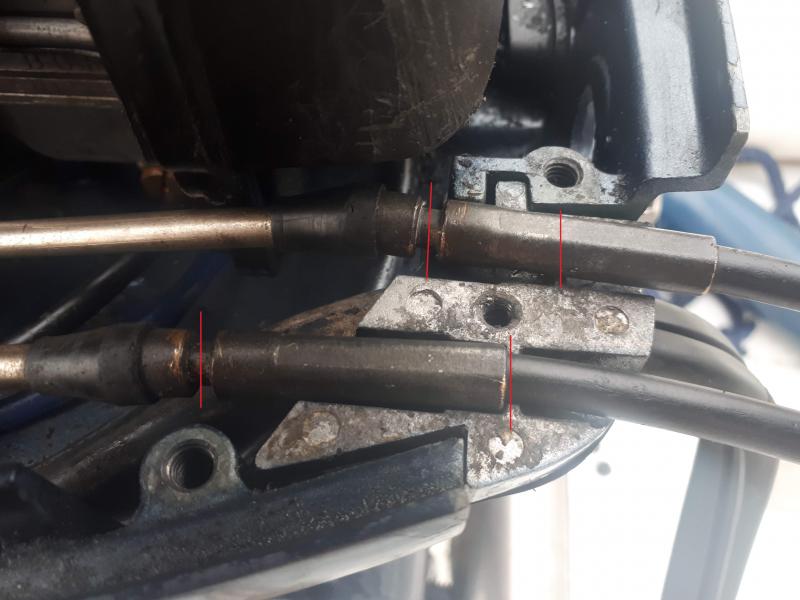

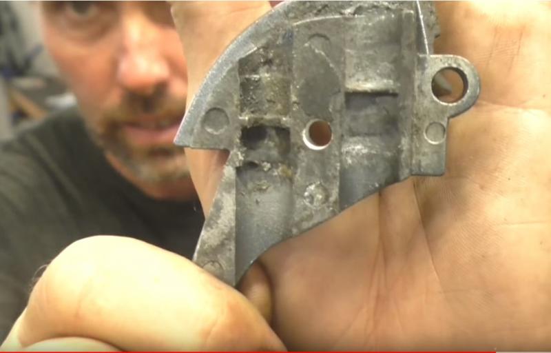

I have problems with installing gas & throttlecables as described in the Dangar Marine Video on reversing a Yamaha 703 forward control.
https://www.youtube.com/watch?v=t3DiUd2WI5k
(go to 7:04) These cables are now too short no matter what i try!
Dangar Marine states this problem is caused bij the wrong locking collar.
Any idea where i can get the right locking collar?

I am trying to make the gas & throttlecables to fit correctly. Just like in the video of Dangar Marine. The problem is, with this locking collar which came out after 1994 while the engine is from 1993.So that, s why these cables dont fit correctly.
Serial from my engine is
40HEO
6H4 S 105337

You are correct. By serial you have a 1993 model year motor. The equivalent of a USA model 40ELRR.
If you go to the Yamaha USA website you can view the parts catalogs for the USA models. In the illustration labeled as "Bottom Cowling" you will see that the 1993 model used one set of part number brackets (-00-94), the 1994 model used two sets of part number brackets (-00-94 and -10-94) and the 1995 model used one set of brackets (-10-94). Seems that Yamaha made the change in the 1994 models.
Presumption is that you have the -00-94 parts and you need the -10-94 parts.
