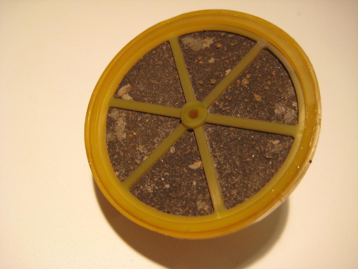

Both motors are running between 130 and 140 degrees. On last trip out the starboard engine would occasionally lose some power then regain. Could really feel the power loss and power up. Found that both the water fuel separator filters were Mercury 20 micron filters. Changed both to proper Yamaha filters and cleaned the canister filters on each motor. Having trouble with getting the port motor filter seal to set. Starts a small leak around the threads when the fuel pump turn on. Starboard filter is not leaking. Starboard motor still bogs down. Any trick to the filter or suggestions on the power loss? I assume 130 to 140 degree temperature is within proper range.
image001.jpgI think we have found the problems.
