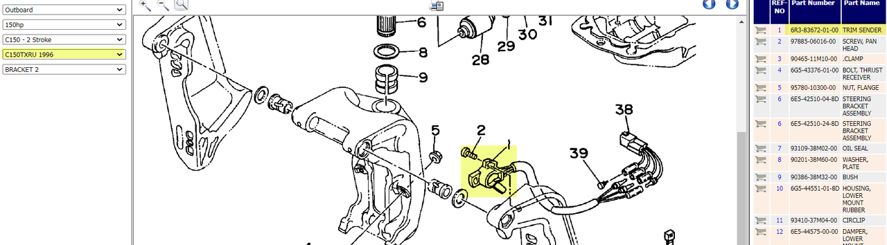

Looks to be the equivalent of a 1996 USA model C150TXRU. Sender part number is 6R3-83672-01-00.

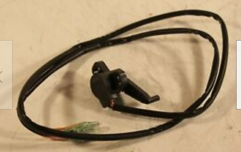

Does it look like this one?

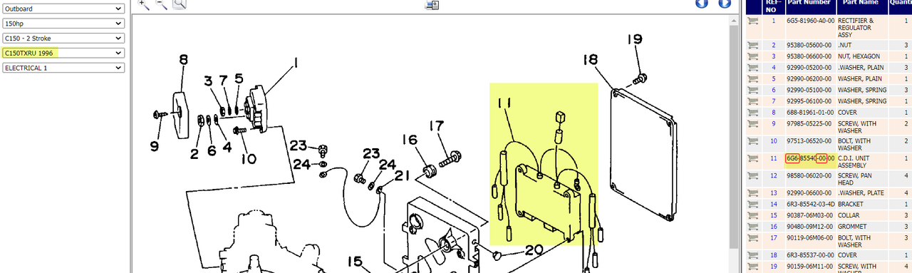

Look at your CDI assembly. Is it marked with 6G6 -00?
If you want to see a parts breakdown for a C150TXRU you can do that at www.yamahaoutboards.com. Click on the "Owner Center" button. Then on the "outboard parts" button. Follow the steps from there to get to the C150TXRU model.
Thanks for that. The three wires and connectors are right but the arm may still be a bit longer. Trying to load a photo of mine but failing. Clicked on photo emblem above. Found photo and added but won’t seem to upload to post.
I've looked at other images of that part number and its not right. The arm is to long and on mine the 2 fixing holes are almost parallel where as this part is more of a V. I will look for the number on the CDI unit tomorrow and report back In the meantime many thanks for your help

If one cannot find the alternate ID label on the block, then the only numbers/letters that might help are those on the CDI assembly and those on the carburetors. Anything else will send someone down the rabbit hole.
A 1996 C150TXRU uses CDI assembly part number 6G6-85540-00-00. Which further leads me to believe that your motor is the equivalent.
It is possible that someone ahead of you installed the wrong trim senders. Which may fool you into thinking that the corrects ones are wrong because they don't look the same.

The sender I bought is actually the part number for the above engine. Definitely doesn’t fit. Thank you anyway for your attempt to help me.
