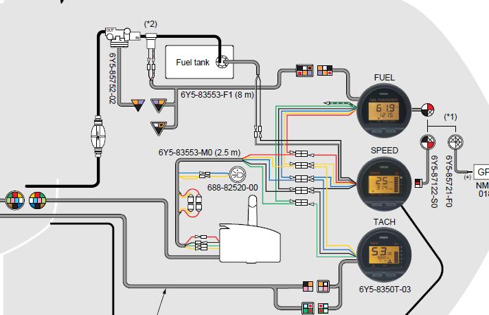

I have new dual gauges the tack is 6y5 8350 t and speed 6y5-83570- a0 flush mount control new 10 pin harness also trim and oil harness, new key switch 64d82570-32 , everything was plug and play, now the tack lights up with a 0 doesn’t change when running also same gauge there’s hours that read zero I know the motor has 780 hrs it’s like cpu is not signal the tack, the trim is indicating on the trim side of the gauge works, thx again for your guys input
Also 6y583553-no from key too the dual gauges
The 6Y5 tachometer does not display ECU hours. Only hours recording within the tachometer itself. If the tachometer is new it will only display 0 hours.
A green wire in the ten pin harness provides the tachometer signal to the tachometer. Via the dual fused harness.
