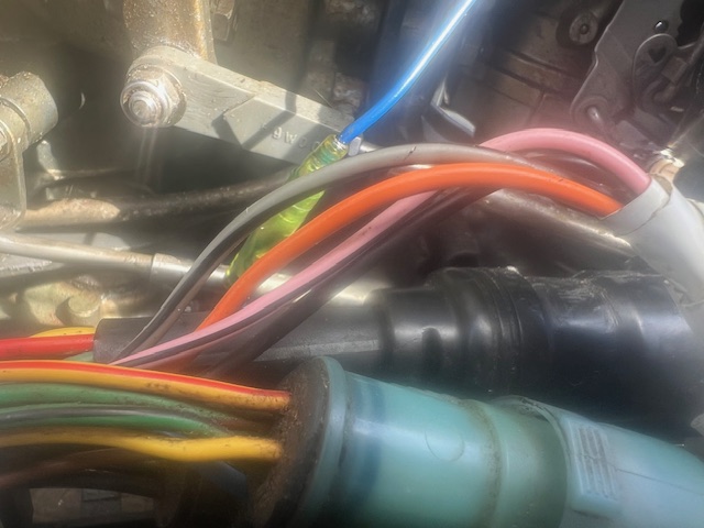

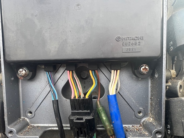

I am looking for wiring information I had cables what going in front dashboard and had no idea please see photos this cables going from cdi

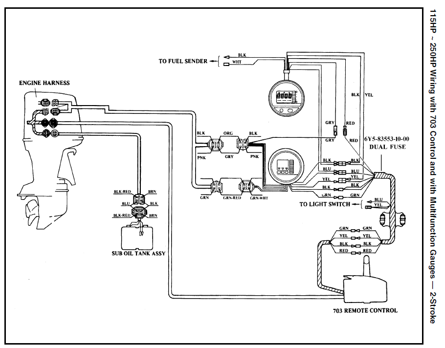

This is how Yamaha depicted the wiring. Assumption being a Yamaha multi-function tachometer was being used with the motor.
