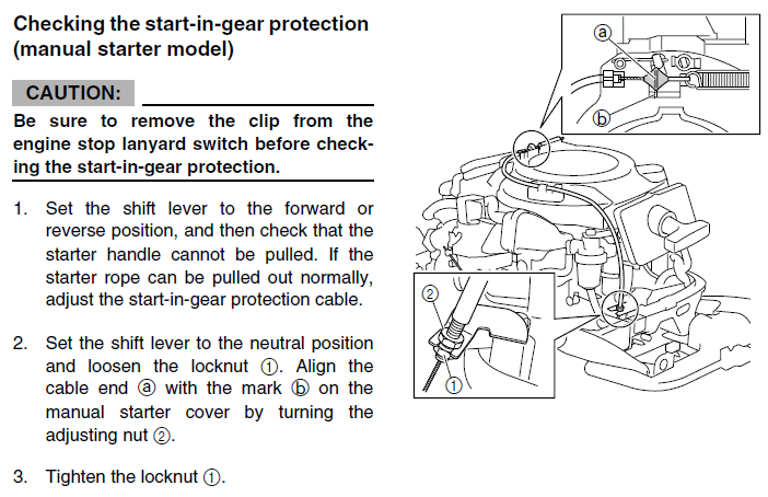

I’m not sure iif anyone else owns the same motor or if yours has same set up, but something is missing here, but when u put the motor into gear, this little device is suppose to move forward and back to stop the motor being able to start in gear..
But when I select neatural to pull start the motor, it does not move to let me pull the start cord..
It’s a 15hp 2019 4 stroke..
I can push the little black piece back by hand to release the locking mechanism.
Anyone else got the same motor to see if there looks the same..
Cheers all..
