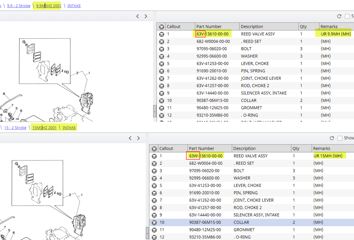

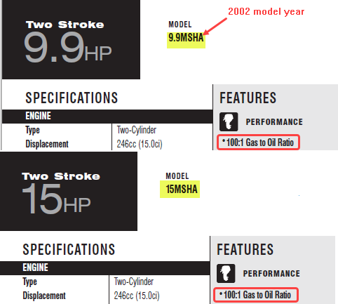

Could someone help me with the difference between the 13.5 hp and the 15 hp 2-stroke Yamaha outboard motor? I tried to compare several parts according to the factory numbers, but I couldn't find any difference. The carburettor also has the same part number.
