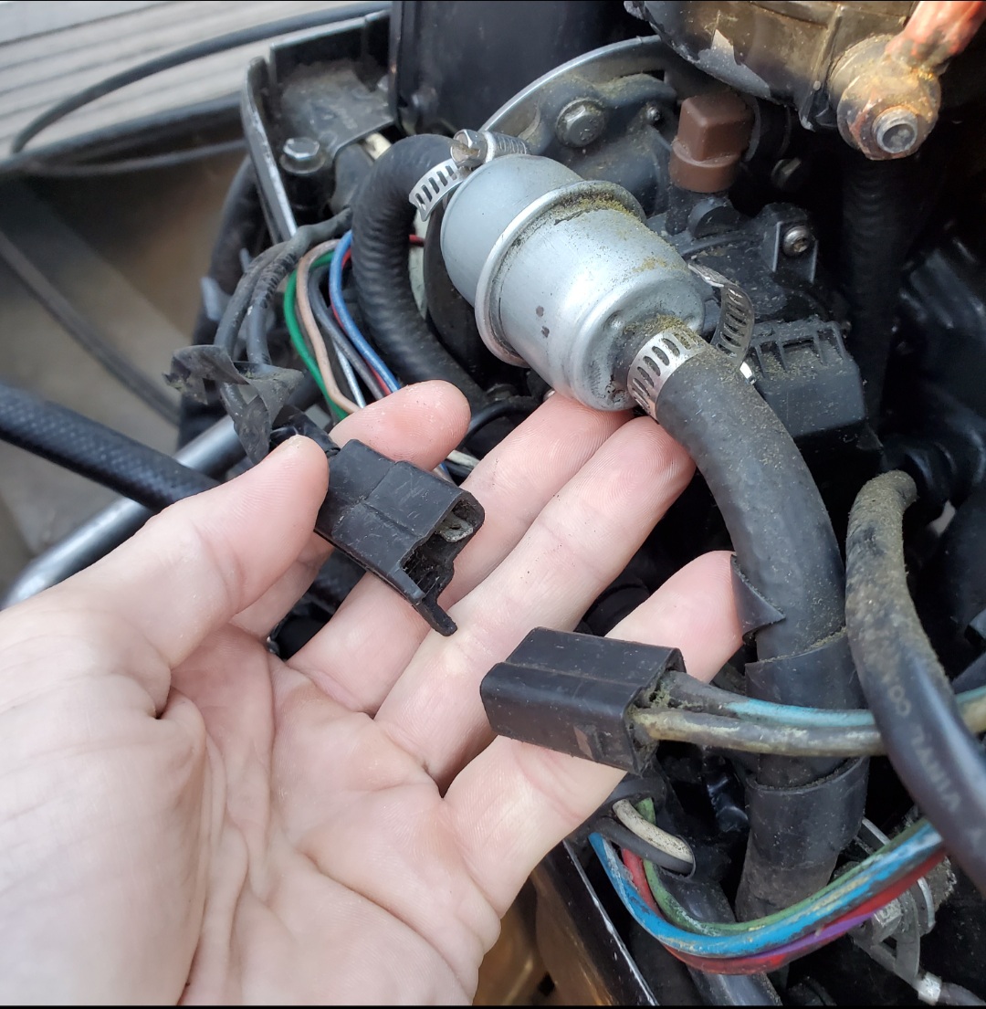

And would you happen to know what the pigtail connection is to it wasn't connected and I see one of the pins is broke.
The latest water pump kit 0432955 has instructions to move the tell tale and make cooling system improvements.-----Those should have been done as per a service bulletin in 1994, yes 1994.---Do a complete evaluation of this motor before spending any beer tokens.-----And do a compression test for future reference.----Post the numbers here.----If those wires are blue and green they might be for the power trim motor
