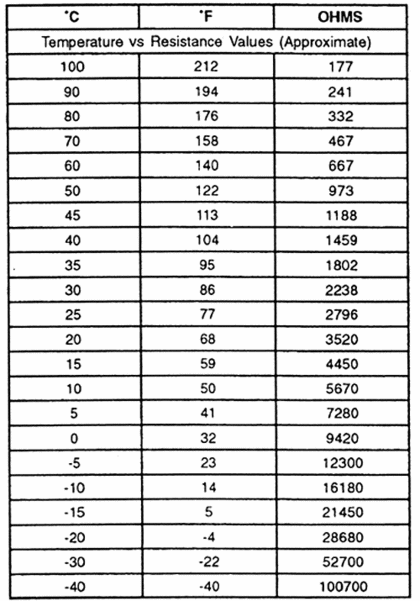

That sensor has one yellow wire, one black wire. Measure its DC resistance with a multimeter- if it's much higher than what the chart shows for a given temperature, replace it. The chart shows the resistance range-

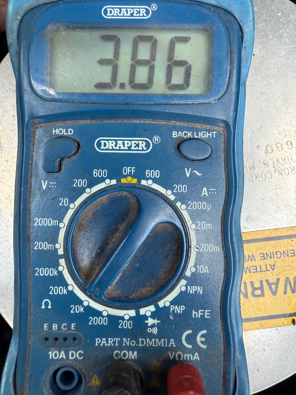

Here’s the reading for the temp sensor.
It will only read on 20k any lower and it just reads 1.
Not sure if that’s 386 ohms or 3860 ohms ?

That means 3.86K Ohms, which corresponds to roughly 59°F- that's exactly what I referred to WRT low temperature from sensor to ECM vs hot engine. At 59°F, it's getting too much gas. If possible, go to an auto parts store and measure the resistance on a new part- it should be ~2700 (or 2.7K) Ohms. It's out of range.
Ok that makes sense.
Would the sensor not be reading the temperature of the water now which would be around the 59*f as the engine hasn’t been run for over 24 hours?
it will read the coolant temp in the block...if the engine has been dormant for over a day, its probably close to the air temp...if its in the mid 60's (deg F) where you are, then the ECT is accurate enough...
yes air temp here is around the low 60's so looks like its reading correctly. would it be worth checking again when on the lake when engine is hot or if its working ok now it should be ok when hot?

Yes- definitely worthwhile-they can fail by not changing resistance with increased temperature. If not nothing else, if the hot start problem occurs again, you can open the throttle and see if it will start- at that time, I would also measure the resistance to see if it changed, or you can remove the sender and put it in a pan of water on the stove- start at room temperature and re-measure as the water becomes warmer, comparing the resistance with the chart as you check the temperature.
As you saw after measuring the resistance, it showed 3.68 K Ohms- how does that compare with air temperature?
I’d say it matches the current air temp at the time of testing it at 3.68k
