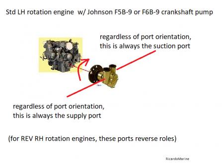

With the crankshaft seawater pump:
there is no bearing side load from belt tension..... they offer easy cover removal for impeller access.... etc.
With the belt driven seawater pumps:
they will undergo bearing side load from belt tension ...... they offer more difficulty accessing impeller in which it often causes deferred impeller maintenance.

The water comes from the jet pump in a jet drive, so it just replaces the seawater pump. The ones I've seen didn't have bypass flow on them, so there was almost zero flow when engine is not up to temp (which I suppose is okay, but doesn't seem ideal to me). Erratic yes, since jet pump flow is highly dependent on engine RPM, and from what I've seen, stops almost altogether at idle - you have to keep the engine above 1000 RPM to get much of anything. Fine for a hot rod speed boat, but not in this case. I understand that many jet boaters have resorted to crank mounted pumps anyway because of this very problem. This behavior is actually very similar to what I've experienced with my cooling. Slowing to idle after sustained running has always been an issue (if I remember, this used to even occur on the old bone stock 6-banger).
Perhaps a better comparison of this setup would be a straight inboard configuration - which is essentially what I've now got (in terms of the engine cooling). I don't have any data from the direct drive community, but it looks like the recirc pump is often eliminated in V-drive systems. I've also heard of folks doing something like this with Bravo systems (which I understand uses a belt driven pump?). Maybe that's just a different style recirc pump, I'm not up to speed on Bravos.
I suppose the lack of recirc pump might somehow exacerbate some cooling problems. But I also can't get past the fact that the recirc pump merely "manages" flow - it does not produce the flow. In fact, I've read that in some sense, the recirc pump actually restricts flow that would otherwise occur in its absence (but that probably falls under the "everybody's got an opinion" category). In my case, the situation has gotten a little worse and the engine wants to heat even at speed. So, in troubleshooting, I found that my lower unit seawater pump is not putting much out even at higher RPM. I had the option of just replacing the pump (again) and hoping for the best. But after considering the major maintenance improvement of a crank pump (actually gives you incentive to inspect and replace the impeller) and the potential of solving the longer-standing issue of marginal cooling under some conditions, I opted for this modification.
Rick, I appreciate your time and experience. I realize what I have is way non-standard. I'm admittedly creating a "work-around" to solve a long-standing issue on a 50+ year old boat, in an attempt to continue to get some use out of it in its (and my) golden years. What I'm after is something that works and is safe. I "think" the setup I'm working on will meet this goal. If it doesn't, I will have to go back to the drawing board (which may involve tossing in the towel on this boat altogether and starting with something a little more modern).
