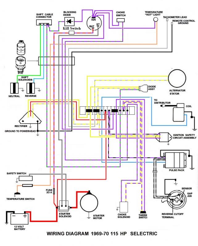

Identify the purple wire leading to the ignition switch from the motor cable. Disconnect it from the ignition switch and connect it to one side of the kill switch. Connect the other side of the kill switch to the ignition switch where you disconnected the purple wire. In simpler terms, the kill switch goes in series with the purple wire.
