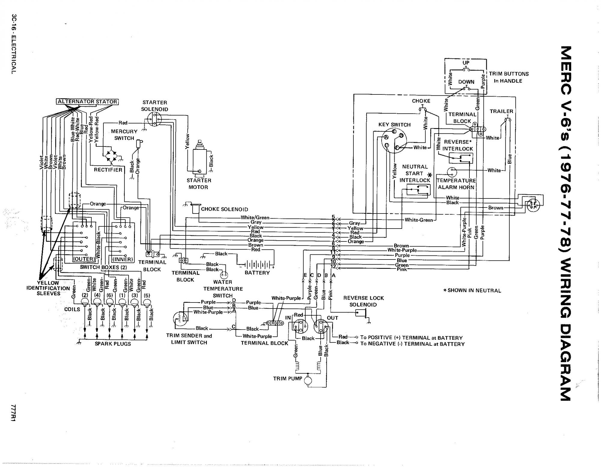

ok i have a 150 black max says 1978 by serial#5024710 i took this motor off my boat to redo transom and floors and took out control as well i unhooked the wiring from the motor instead of just unplugging i took pictures at the time so for easy hook up but phone croaked and lost all . now i cant for the life of me find any pictures or diagrams with same colors on wiring harness to help me so any good pics showing or good diagrams would be welcome as i am ready to do some test to this motor and get it going before i hang it back on the boat thanks
dont seem to be allowed to add photos so here are the colors of control pig tail big black big red bat leads i got them fine smaller wires red, black, brown, grey, orange, yellow, pale green or white
thanks guys for the picture and link the pic nails it be hooked up in am . i am so glad to have it been searching for ever thanks again
