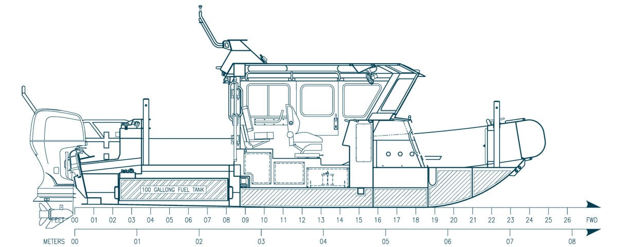

no - it's a pretty steep grade (only spot i have) and old USCG boat had weird long shallow tank design. one year i had it on the trailer in the spring at about 95% full - which was fine, but then on a super hot day - air expanded in the tank and pushed gallons of fuel out of the air vent - was pretty scary.. at about 80% seems fine.
So when full, on the driveway, I would assume the fuel level will actually block the vent off and the air would be at the rear of the tank? Pushing the fuel out?

it's parked stern downhill / bow uphill to allow the rear decks to drain. the vent and fill are on rear side, but not quite sure where the vent tube runs to, assume it's covered by fuel when on a pitch. schematic below. sounds like i'm good with some air inside if using stabil, so maybe not a concern...
