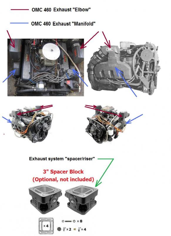

I'm curious why there are brass nuts on the mounting studs for the risers on the exhaust system of a 454 crusader engine. The exhaust manifold is cast steel,
Most likely cast iron!
the 9 3/8” X3'8” long stud ( 4 for each exhaust manifold ) is stainless steel that screws into it. Then the 2” thick water adapter slides on the studs
I think that those would be your risers/spacers.

and then in my case the 8” riser slides on the studs.
I think that these would be your exhaust Elbows.

The first couple inches of the stud is holding the cast iron water adapter in place and in it is antifreeze/coolant/fresh water. After that is the block off plate, so after that is the 8" riser that circulates salt water.
What are you calling a "cast iron water adapter" and a "8" riser"?
(see images below)
But having said that, I don't see how that would have any effect or bearing on the situation. As for preventing leaks DJR, If the gaskets are doing their job no fluids should be traveling along those studs at all, right?
I would agree!
These are examples only.
