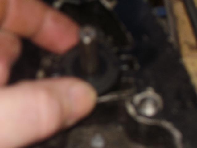

Which way does this guide go it is located at the bottom of the shift shaft rod that goes on top of the L/U shifter in the pic will you see this if your looking up toward the top of the motor or will you see the other side which is flat?I think I got my shaft problem figured out there was play at the top of the linkage I tapped it down and the rods tightened up dropped L/U again need to make sure which way this goes I'm tired of removing the thing Thanks Mitch

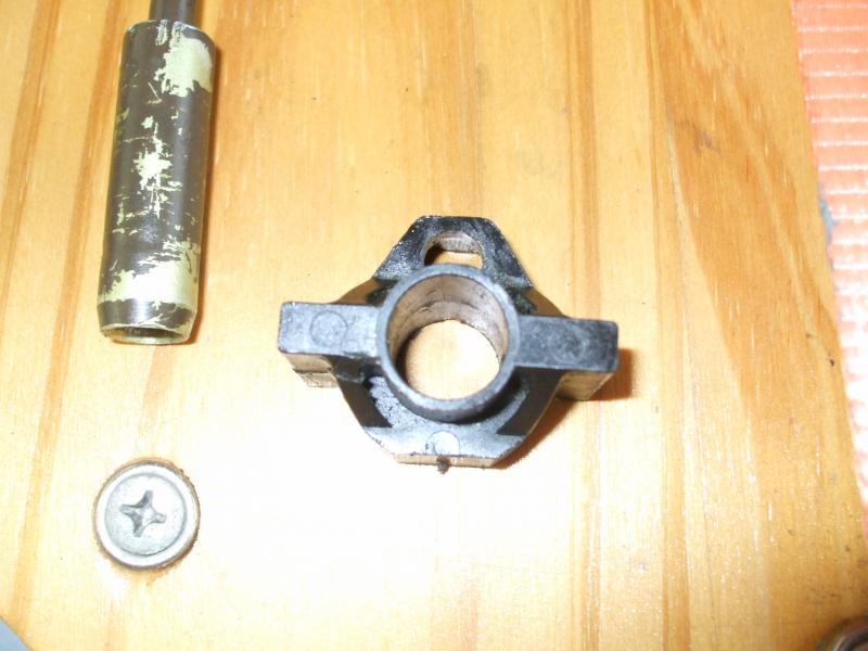

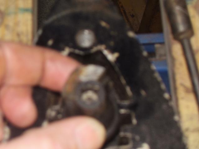

Not exactly the same but close enough.The white piece in pic three is the same idea as yours but only the shift shaft guide on yours.The first two is the reverse cam and spacer in the lower unit.

thanks alot It's kinda hard to tell but it looks like I stick the flat side in first and the other part is what I see like it is in my pic thanks so much I'm going to run try it out in a few
My apologizes,I didn't state that very well. What you have is the shift shaft guide and it fits into the leg not the lower unit,my pic three is the bottom of the leg/mid section.
Pic one is the spacer,goes on first on the lower unit.Pic two is the reverse lock cam goes on top of the spacer on the lower unit,and pic three is as I said.Brain knows but is not transferring very well to post:D
