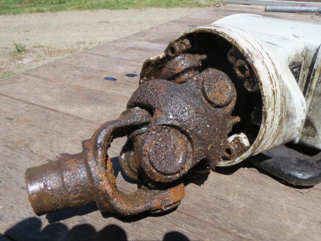

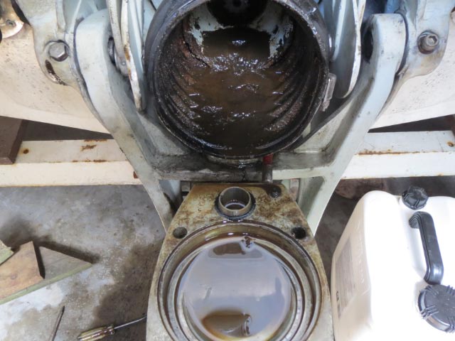

...got the transmission off as per instructions from this forum...easy when you know how, as they say.
What greeted me inside the bellows was not good, oilly, rusty, sludge...
As can be seen I didn't drain the oil from the leg...I should have been more careful as some of the bellows muck fell into the oil pool. hopefully it will all come out when the oil is drained...B.

Barry, that is most definitely a pre- A transmission, and will have the all steel bearing box, with the separate aluminum clamping collar.
Please take heed of my caution notation in my previous post.
If you can successfully remove the 4 cap screws, the rest will be a piece of cake.

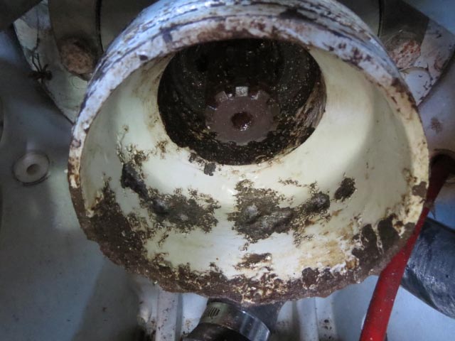

...more of what I uncovered!
What's the name given to the piece on the right that is in the transom ...it has serious corrosion and I am reluctant to proceed any further with the project unless I can find one in good condition, does anyone know of a good used one for sale...I don't imagine they can be bought new unless in exchange for an equal weight of gold...? B.

...I've been learning a lot since I made the above post and now know that the part I enquired about is the bellows snout on the end of my double bearing PDS housing...I've read that a fix for corroded ones like mine, is to machine them off and get a new piece lathed up.
Has anyone done this...can welding be done without distortion or could it be epoxied on given that its only carrying one end of the bellows?...Barry.
...I've been learning a lot since I made the above post and now know that the part I enquired about is the bellows snout on the end of my double bearing PDS housing... I've read that a fix for corroded ones like mine, is to machine them off and get a new piece lathed up.
Has anyone done this... can welding be done without distortion or could it be epoxied on given that its only carrying one end of the bellows?...Barry.
Yes, yes and no.
Go to a salvage yard and pick up good used 4 cylinder flywheel cover for the donor snout.
Have a machinist make both layouts and cuts.
The alignment for the bellows is not critical.
Have this TIG welded on to the old F/C.

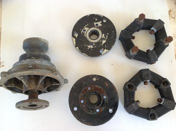

A couple of photos...one of which you've seen before but the other shows some items for sale online here. Spoke to the seller by phone and he thought the PDS adapter was for a V8, but he didn't know which one.
You may recall mine is a SB Ford...are you able to tell from what you see if its for a ford or GM or something else? Barry.

Your photo to the left shows some very old parts. It shows a rather ridged drive coupler that I would NOT use.
The Borg Warner/Volvo Penta PDS adapter housing will work with any engine that is Borg Warner pattern flywheel cover capable.
To our left here, I show a Borg Warner drive coupler cushion or damper "hub" system (shown separately from the outer plate assembly).
To the right here, I show how the PDS assembly would look via a "cut view".

Cheers Rick, you say...."the B.W./VP PDS adapter housing will work with any engine that is BW pattern FC capabable..."
....so are you saying the adapter housing in the " items for sale" pic is indeed a BW item and therefore a direct replacement for mine which you identified as a BW item in another post, or is it unidentifyable?
Were all the bellows snouts the same OD?...B.
