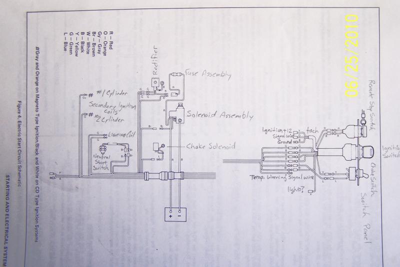

Now that I've rebuilt my motor, I'd like to install an hour meter. I'd like to do a tidy little install in the lower cowl or on the motor itself. I don't wan't to use the ignition (run) wire. I've found some small meters that run on magneto power. Would that come off the primary ignition wire or the lighting coil wire?

I found power off or the 2 lighting (charging) coil wires; the same two (green on my Mariner) signal wires that the tach use. I used a curcit tester to feel my way around. Every thing else will give you power when the key is on even if the motor is not running. One signal wire and a ground will give you power only when the motor is running, but it pulses. Both signal wires give you a steady power supply for an hour meter only when the motor runs. I don't know if you can do this with all hour meters; the one I bought was good for 4/40VAC/VDC and can run off a magneto.
000_0216.jpgView attachment 3498View attachment 3499
I do not have a stator as I have a magneto and a lighting coil (see attachments). I believe that I was able to get AC power buy using the two lighting coil leads ,as you said.
