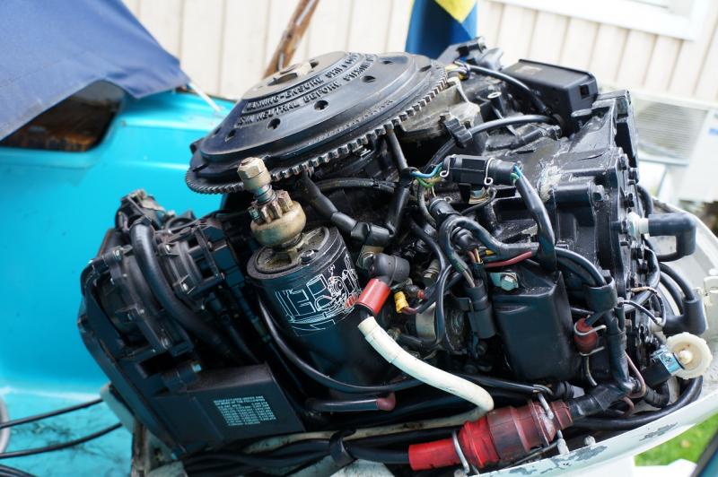

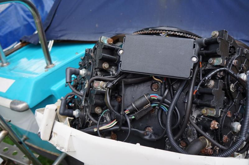

I am currently looking at a few boats, and one of the boats has a claimed 1998 Johnsson 90 hp VRO.
Could you please help me to verify if this seems probable, since there is no sticker with model / serial I took some pictures and hope the forum will be able to help out.
The engine has not seen the best of care as you can see....
Thanks in advance.

Need a picture of the cowling if it has not been painted or altered.-----The red plug on the harness was not used in 1998 for one thing.
That appears to be late 1980's ( 86 / 87 / 88 )---------Need picture of the side of the cowling.-----------------Good solid motor.----Do a compression test before handing over the money !!
Right now I cant supply more pictures of the cowling.
So it seems that the engine is 10 years older than the seller says?
Hmmm....
Motors are often mis-identified by 10 years.--------See that all the time.-------------Must be common all around the world.
