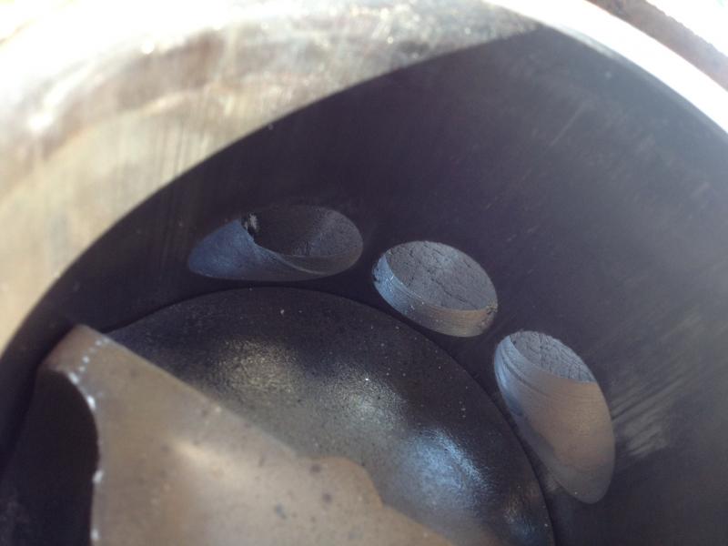

update. I removed the exhaust cover and have attached pics of the lwr cyl and piston. both the piston and cyl have light scrapes, you can see them but it is hard to tell by feel that they are there so I would guess they are .005 or less. I had to do a lot of resurfacing of the head to get it flat so I think the head warped which explains the original compression loss. After resurfacing the head I temp re-installed it with the old gasket with some gasket sealer on the sealing ring. I got 129 on the top and 122 on the bottom cyl when I did the C check. The rings seemed to have more spring and bounce on the bottom piston then the top? Plan now is to find new gaskets and bolt back together unless you all think that with the scouring that it is a grenade ready to go off. BTW the impeller is toast, all the blades are gone. TKS

It looks like it is 2 to 0 for the motor is no longer usable with out a rebuild. I searched all day for used motors but drew blanks. The compression check went OK with no weird noises so I don't think the piston is hitting. If I cant find a replacement in the next couple of days I may have to throw some gaskets and a impeller at it and give it a shot. Thanks for your opinions.
I got it started and it seems to run well on the Ears. Hopefully I can load test in in a couple of days.
I am a happy camper... Thanks for the help
