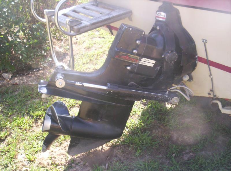

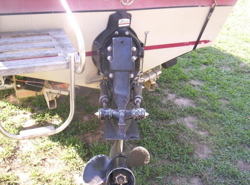

Hi, new here. I just aquired a 1983 Imperial w/ 120 (2.5l) and a mercruiser outdrive. The serial on the outdrive is 226891. The engine is froze up and I am trying to identify what year engine I can put back in. My research shows the alpha 1 came out in 1983 but my drive does not say Alpha 1 and the serial # doesn't seem to be an alpha 1 ser. #
Want to hit the junkyards but I just keep seeing where only certain year engines will bolt right up?
Any info appreciated! tryintofixher
post a pic of the drive. It says mercruiser on it ? Not unusual to have a drive or motor from the year before maybe it's a pre-alpha.
You can drop a 3.0 in say up to 88' and just go boating no need to do anything else to the drive.
The 3.0 can be of any make, just change over the carb, mani, and riser, in one piece if it's other then merc.
Yep, says mercruiser..pics attached...thought I read in another thread that 3.0 required diff. flywheel or adapter or something?

Update: I missed a # on the serial....6226891. It is an alpha 1.
so with this onfo, any 2.5 or 3.0 to about '88 is a direct swap with no additional parts?
