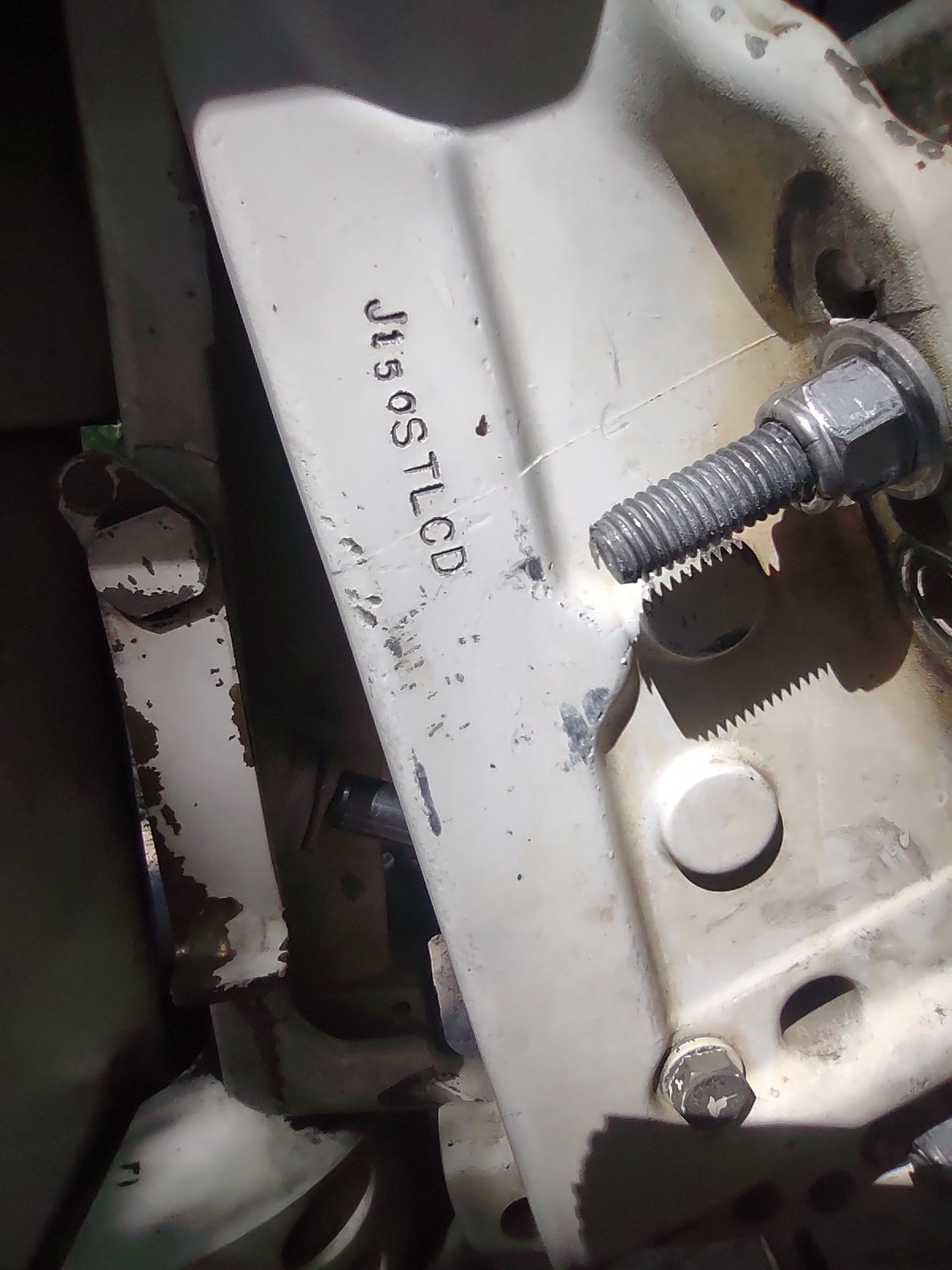

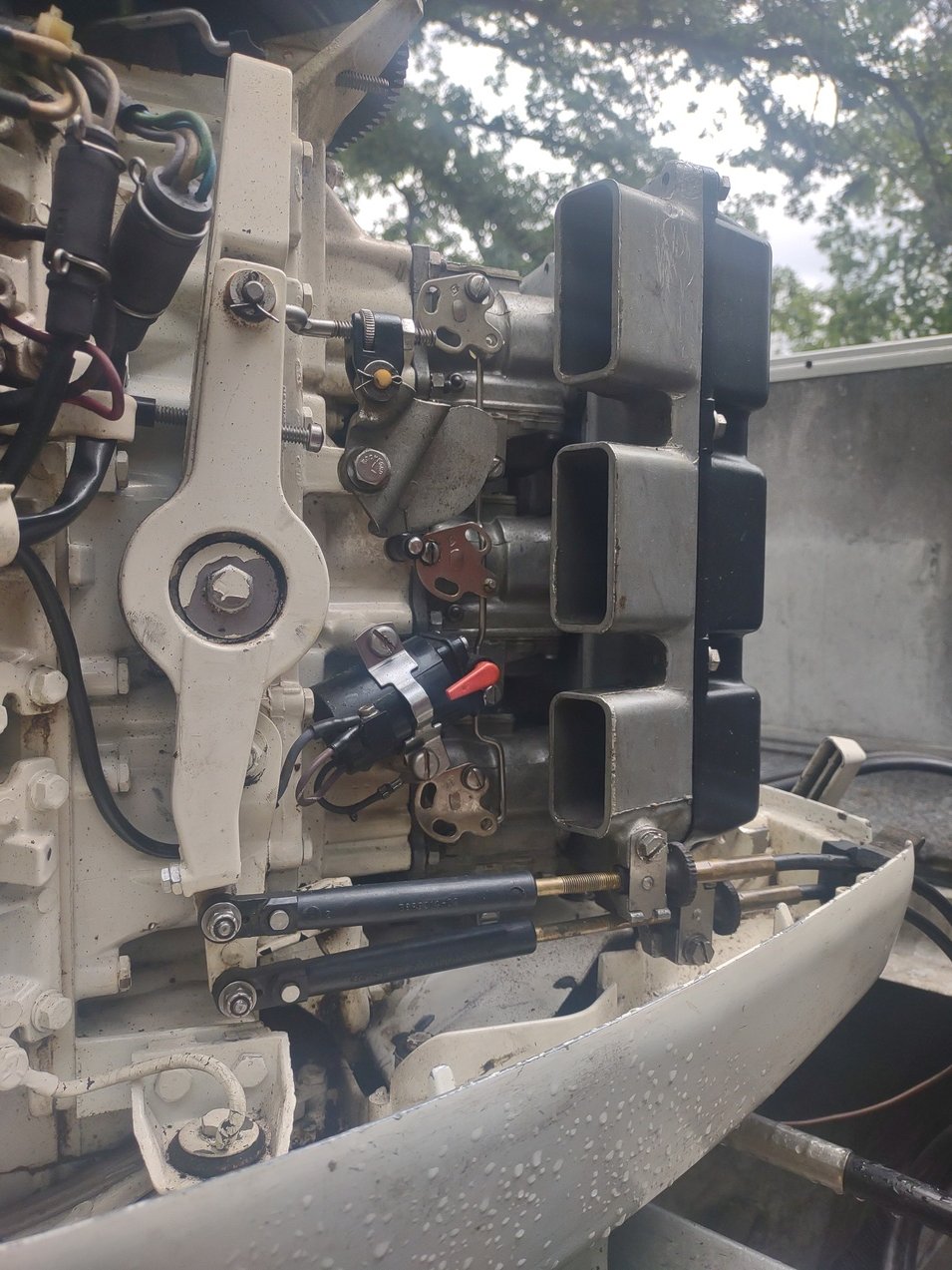

I bought this from a guy in Quitman, TX. The cowling says GT 150 but from what I read here the cowling and the engine don't match. It is a 6 cylinder with 3 carbs. M/N J150STLCD, not a typo.
img_20260401_125817254_63-jpg.36822

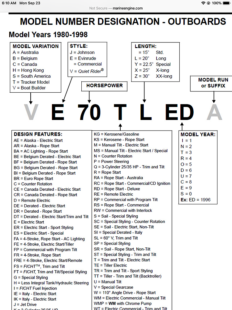

You have a 1986 Johnson 150. I'm not really sure if the GT was anything special or if it was just branding to sound good. It could be the previous owner damaged the engine cover and just sourced another one to replace it. The #1 thing to use for your engine is the model # from the tag on your transom bracket. Follow this link to the complete parts page for your engine --> 1986 Johnson 150 Parts Diagrams
