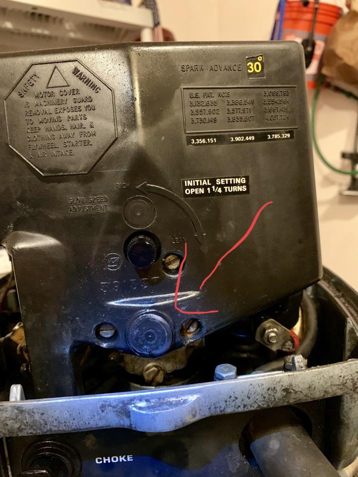

Hi ‘81 35hp evinrude. Noticing front of motor pretty oily. This cap isn’t in tight. What can I do? Thx

It may affect the high speed operation if you leave it out. Maybe yes, maybe not. The motor uses sound waves as part of the induction tuning system. Whatever, I don't think it is necessary for it to be a tight fit.
Thx that’s how I found what’s called. Anyway it’s on the way. Ty. While I’m at it. What’s the best / easiest way to Dog this motor? I’m in New England but do intend to run the fuel out and keep it the garage this winter.
