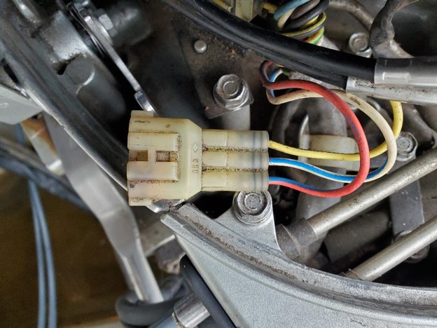

This is a picture of a wiring connector located near the front of my 1998 BF75A just behind the latch. I bought this used. The motor runs good except that the tilt/trim is not working. I don't think this connector is in the T/T circuit. The wire colors are Black/Yellow, Blue/White, and Blue/Red. The connector is labeled Y11. I have checked the wiring diagrams and there are no Blue/White and Blue/Red wires shown. Any help identifying this connector would be appreciated.

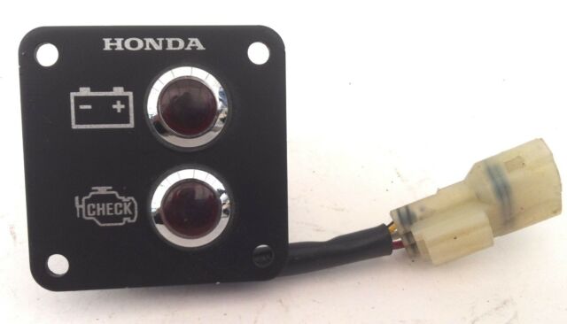

Thanks Robert. Based on the diagrams and the fact that yours doesn't have the connector, I'm starting to think that the connector was added by the original owner for some type of auxiliary device.
