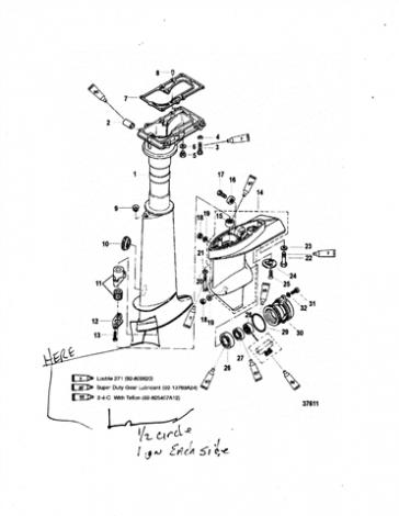

No t-stat on this outboard, and I can't picture the 2 holes you speak of- could you post a picture? Intermittent water flow could indicate you need your water pump serviced- when was the last time the impeller was changed?
Document (1) (Small).jpgHey, thanks guys, upon closer examination with plenty of light, it is a 0 at the end
of the number. This motor was supposed to have set up at least a year. I saw it
run and pump water as described. Did the same at home. He said he changed the oil in the foot that morning, but I think he may have been covering something up. Today, while
checking the numbers, I saw white emulsified oil collected on the foot where it sat in the
water. Hopefully is a drawing of where the holes are that are blowing air bubbles.
They are at the line where the drive shaft housing and lower unit bolt together.
