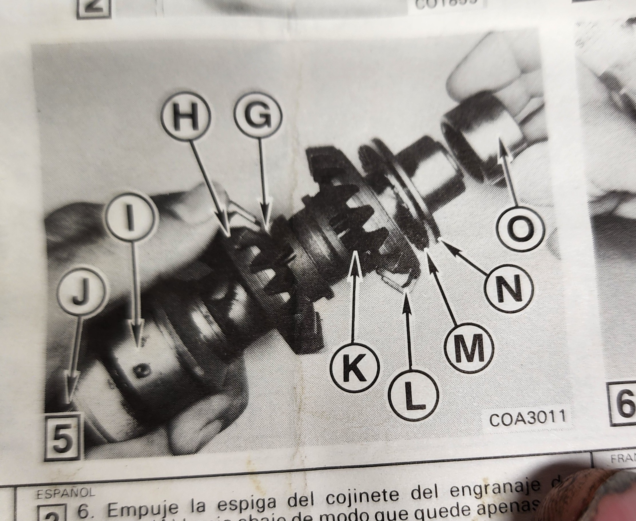

I pulled the lower unit to reseal it and install the 390970 forward gear upgrade.
I got the forward gear set up on the prop shaft, but in the installation instructions, it says to use a thrust washer between the new forward gear and the clutch dog, which would rest against the dog splines. I'm not sure what thrust washer they mean, because if I try to use the one from the original forward gear, it's too tight and the assembly won't go into the case half.
At any rate, I did not use the thrust washer, and put it all together dry of sealant to check it out. Seems like the gear mesh is too tight to the pinion. If I back off the screws slightly from tight, it feels good. Do I need a thinner pinion thrust washer, or is there maybe a particular thrust washer that's used with the 390971 forward gear...
the instructions clearly say---" do not use a thrust washer "----
That would be for the 390972 kit which uses the 390973 forward gear.
I have the 390970 kit with the 390971 forward gear. It says use thrust washer with 390971, but the one from the original gear is too thick to fit.
Install instructions

Well, I figured it out.
Somehow I had a high spot I didn't notice when I removed the forward bushing pin from the housing. It was just enough to pinch the bearing slightly when it got tightened up.
I figured it was at the forward gear somewhere, because when I loosened just those two screws, it was fine.
So, after taking care of the high spot, everything feels and sounds good, and gear mesh looks good marking the gears.
