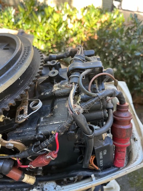

Some mice ate my wiring on my 1989 Johnson 30hp outboard and I’m trying to figure out which parts to replace. I was going to upload a photo but apparently can’t. Basically there’s a wire on the top of the motor that is severed.
Any insight would be appreciated.

Here is the photo. Thank you edchris177 for the tut

Here is the photo. Thanks for the tutorial.

I would say buy a piece of wire.----Buy a pin or socket to replace fit wire in the rubber plug.----Then go fishing.
