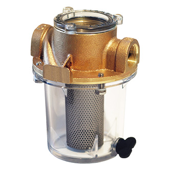

Not advisable!
You will want to collect any debris before it reaches the seawater pump.
As for wire mesh at the end of the outlet....... the mesh would provide a very small area of filtration. Very easy to become restrictive!
Why not install a Marine seawater strainer ahead of the seawater pump?
The square area of filtration is large and will not restrict flow.
