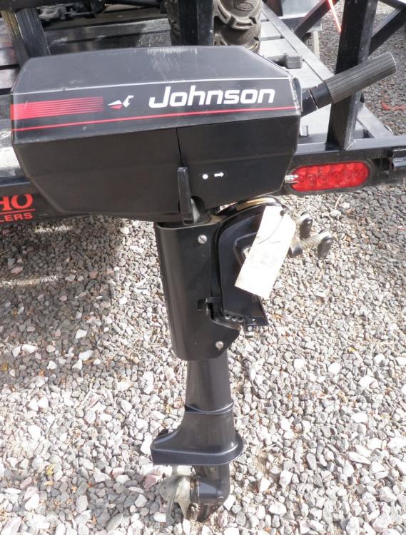

My 1996 Johnson Seahorse 4 hp is essentially new. It has been in a barn for the last 17 years. One of my uncles owned it and sold it to my other uncle and he gave it to me. So I know for a fact it has not been ran. I have been told that I should replace the impeller in the water pump. I ordered a pump kit # 431785 to replace the old one.

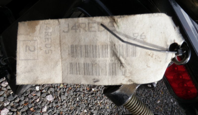

This motor was my Uncles and he had never used it. It still had the hang tags on it. Ron
