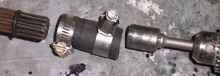

Graham is right--you may have knoced that key out and the impeller isn't turning. I barrel test them with a drill to make sure they're pumping before reassembly. Here's how it's done.
Jeff
