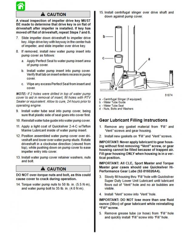

The grease has no effect on the operation of the water pump. If you greased the impeller and let it sit for a long time the petroleum in the grease would attack the petroleum in the rubber and possibly make the impeller soft or swell. "
I grease every pump I put together and run it the same day....No worries.
