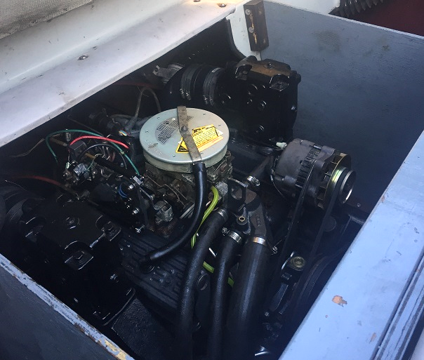

Hi all. Does anyone know how water could get into the cylinders?
I removed the heads from OMC 460 7.5L Ford big block and cylinders 3 and 7 had water in them.
The last time the engine ran was in the boat in the water 3 months ago.
Cylinders are not corroded so the water probably didn't stay there too long.
The head gaskets look fine, with no breaks, but some water passages are completely blocked.
The engine didn't spend any time outside, I don't think the water could get from the top. The carburetor was on with the cover on the top.
The only thing I can think of is water from the wet exhaust while the engine was idling in the water. Is it possible?
How do I avoid it in the future?
Is there any other way the water can get into the cylinders?

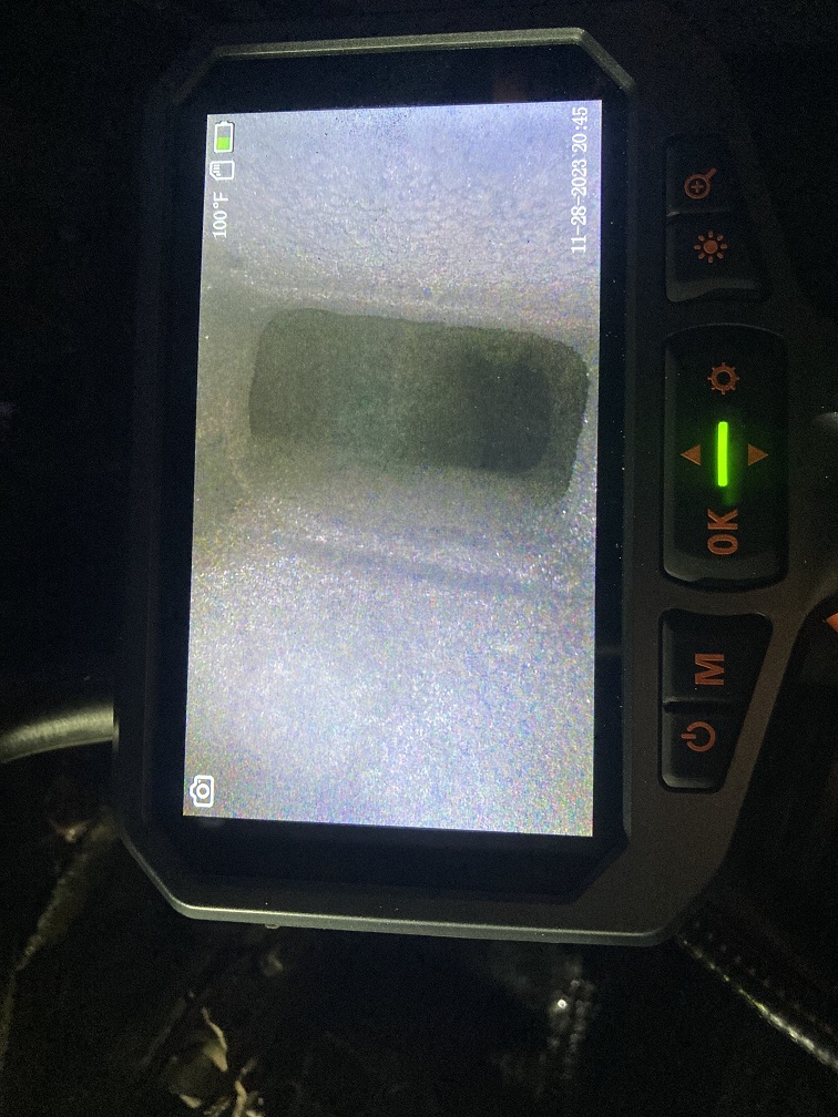

What I was going to say. I actually check mine by removing a plug on the top or side of the elbows & using an inspection camera to look inside!
Why did you take off the heads? Did you have a miss or a compression problem? Is your system raw water in the block or fresh water and antifreeze? Off hand my guess is there may be a crack in the head, especially if some of the water passages were blocked causing a hot spot. Another source could be pitting on the water side of the cylinder in the engine block. This is more common on diesel engines than on gasoline, but it could happen if the engine is high time. Years ago I put a bare block in 6.9L Ford Navistar engine in my pickup. International had six of them at the warehouse, so it was a common problem.
You can see the plugs on top of the elbows, these are for an exhaust overheat sensor that some Volvos use. OMC & Volvo used the same exhaust from 1994 and up. There are also plugs on the side of the elbow that can be used to view the exhaust passage with an inspection camera.

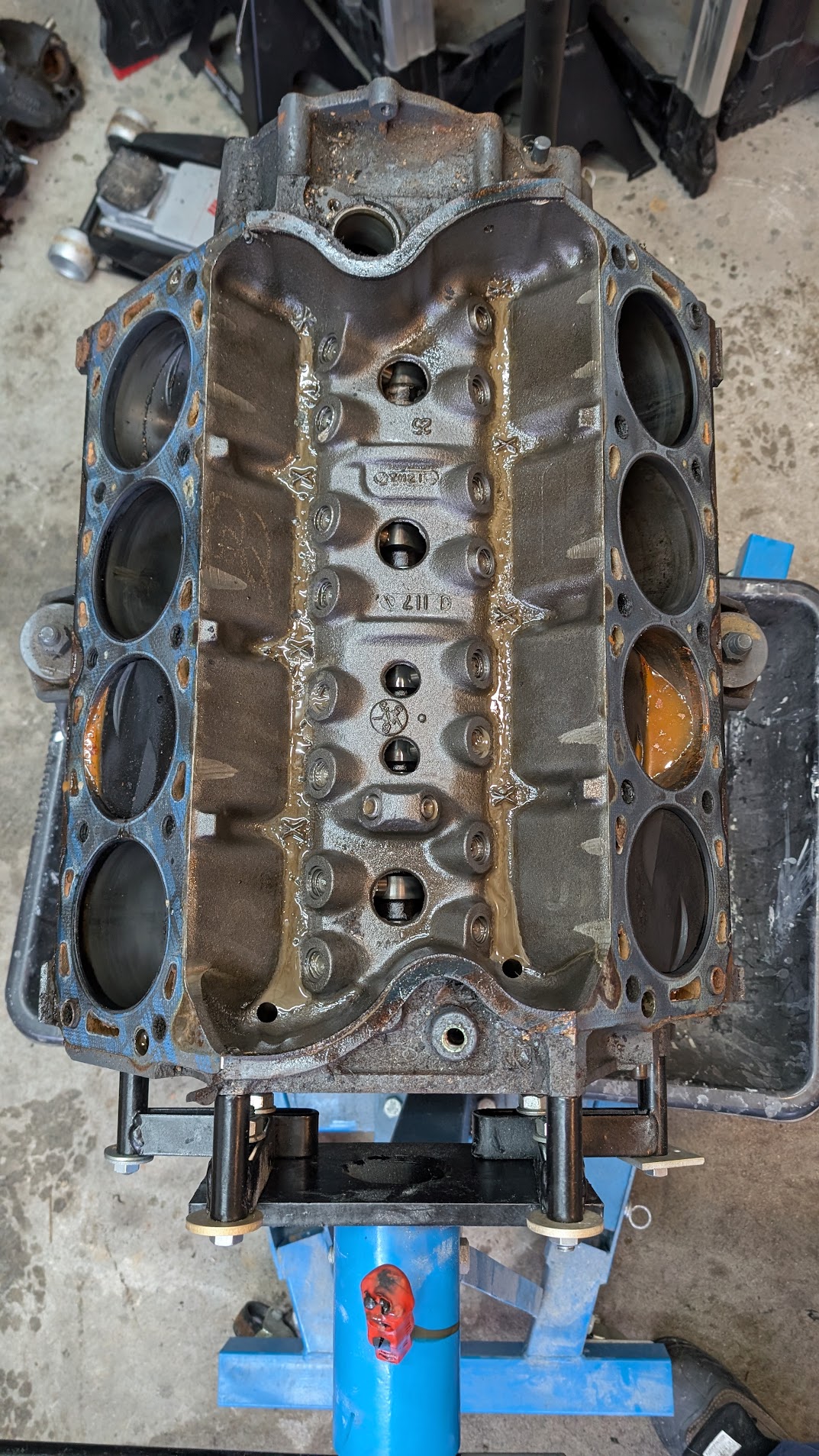

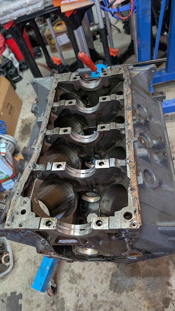

This is a raw water system. i pulled the engine out of the boat to fix the transom, which is leaking.
Because the engine is out, I decided to check inside. One screw after another, and I now have abare block and will do a full rebuild.
im glad i did before that water caused more damage.
The block looks fine so far, but some water passages looked blocked. I'll test it more.
It looks like the water was not in the cylinders for too long, as I do not see any rust damage.
My bet is on the failed riser gaskets, since I recently changed those, and the manifold flanges look very rough.
If I remember correctly, I did file them flat and put gasket compound on top and under the gasket, but I probably did something wrong.
I do have Permatex No. 3, but I used Permatex 80065 High Tack Spray-A-Gasket Sealant on the riser gasket - looks like that was a wrong choice.
If the block has no cracks, I'll go with the theory of failed gaskets and do it differently during assembly.
