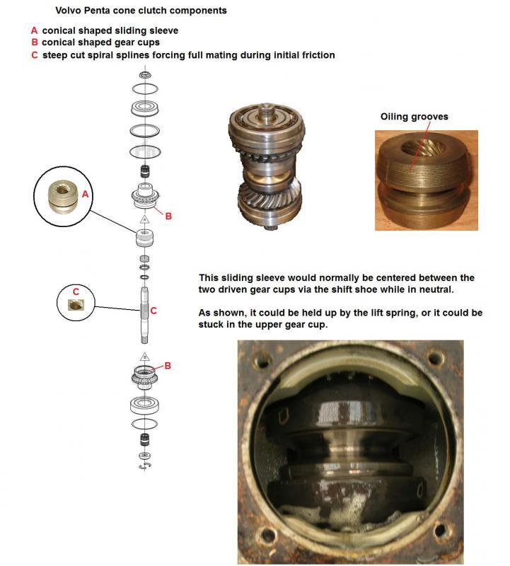

Here's a rather simple explanation that may help you understand how the sliding sleeve and gears cups work.
Gear engagement is accomplished when friction between the conical surface of the sliding sleeve and conical surface of either gear cup occurs.
The steep spiral cut splines cause the sleeve to further pull itself into the gear cup, until eventual "lock-up" is achieved.
Once locked-up, and during continued load, the two will not separate until the load is reduced.
Debris within the oiling grooves on the conical sleeve surface may cause a sleeve to not lock-up, or may cause a sleeve to let go under heavy power, or it may cause a sleeve to become stuck in the gear cup.
The fix will be to disassemble the transmission, and take a good look.
The oiling grooves can be gently cleaned out.
If the sliding sleeve is bronze, these surfaces can be mildly lapped into the corresponding gear cups.
