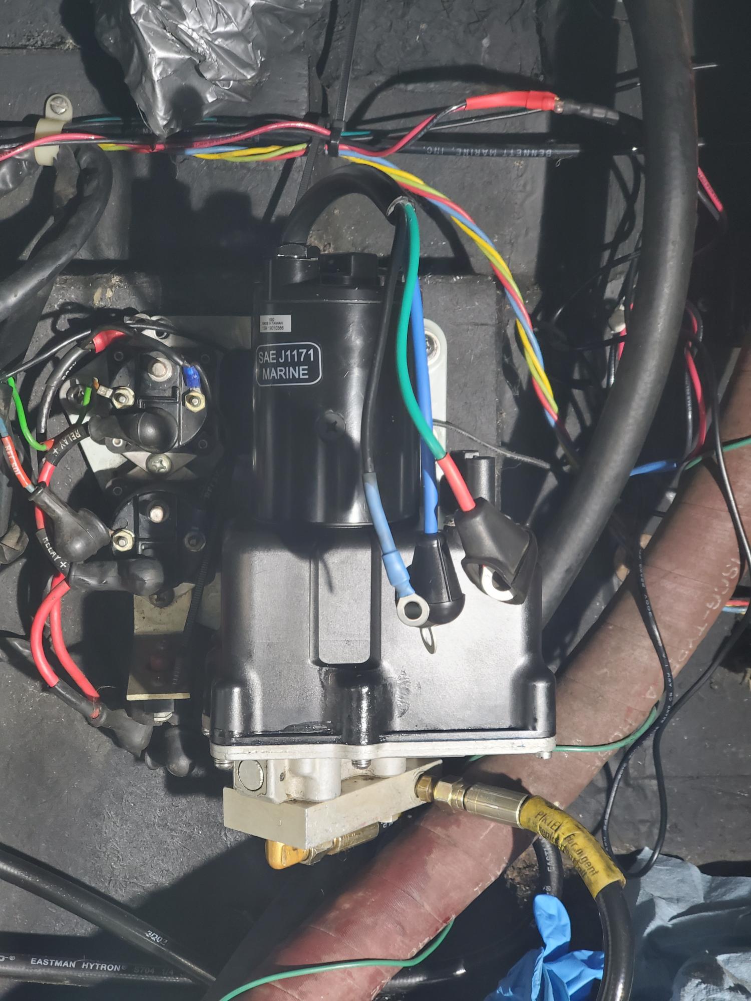

I did a bunch of research, and found that the trim pump used on the aq280pt variants is common with a lot of mid 70s to early 80s Mercruiser stuff. The motor and reservior was very popular, and the variation was in the pump that bolts to the bottom of the reservior.
Arco makes a current production replacement, model 6217. They also sell the motor shaft adapter for use in setups that require the longer motor shaft. I found a rebadged one on Amazon for 114$ Keep in mind this is only the motor and reservior assembly, no pump block on the bottom.
I should be receiving mine by Saturday, and I'll test it out.
I have everything installed, and wired in. If anyone uses this replacement motor/reservior, make sure to pre tap the screw holes into the housing, it's easy to crack the plastic if the screw is too big.
