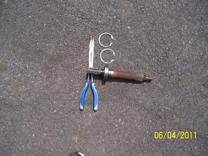

I have done extensive scrounging around on the net and have read of the need to modify and use a long pair of needle nose pliers to get to the snap rings for the pds. So far I have gotten the seal out, and the first snap ring out and can now see the second snap ring right in front of the bearing. My bell housing is red. The engine was a complete replacment with freshwater cooling system and a 2 barrell carb. I bought a pair of sanp ring pliers to get the 1st snap ring out but could never get to the 2nd with the pair I got from Sears.
Yep... a good ole looooooong needle nose with tips modified, will do the trick for the FWD-most snap ring and the AFT-most one.
OK... since the F/C is red, that tells me which one it is.
Yours will be double bearing PDS....., and will need to have the engine removed in order to access the FWD bearing.
Had the later Charcoal Gray F/C been installed, the PDS will be a single bearing, and all will remove from AFT.
Hey Rick look what I've got!!!! Do you think I could make a living renting out that special tool that I modified to get at that second *&%$#@&* snap ring? At first I was sorry that I had started this project but once started there was no stopping and am I ever glad I did it. The bearing is totally frozen. I must have a hybrid drive as there is only the one bearing that you can see still on the shaft. That bearing is a 6206. Thank you thank you for all your help.

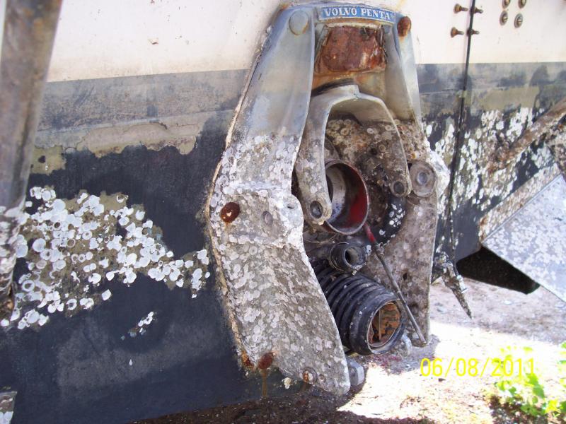

If you'll post two photos of your shield... Port/Stbd side, I can tell you if it is correct for the Y-pipe.

jsrocky203 , the photos that I need to see, will be of the out side of the shield.... the drive side, both Port and Stbd.

You are shaming me into displaying my bebarnacled stern but here goes as I would like to hear the final story and your thoughts on my boat.

The RED FLAG that I was mentioning is there.
Here you show the Stbd side exhaust relief port typically found on both the V-8 and 4 cylinder transom shields.
The Rubber Hook is missing, perhaps the port has been blocked off as is with some of the OHC 4's.
attachment.php
Here you show the Port side, and there is NO relief port that is required for the "double relief" Y-pipe that is being used.
Hence the RED FLAG that I was concerned with.
Someone has installed a 4 cylinder transom shield for your V-8 application.
These two DO NOT belong together! (this Y-pipe and this transom shield)
There is NO Port Side exhaust relief when these two are mated together, in fact, the Stbd relief ports will not even align correctly.
attachment.php
Since your transom shield appears to be rather corroded, I'd strongly suggest that you replace this with the correct V-8 double relief transom shield, and correct all of these issues.
