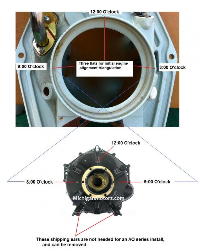

Look closely at this image below.
I am showing a late model GM V-8 flywheel cover, however the 6 flat area idea is the same. as with any of these.
