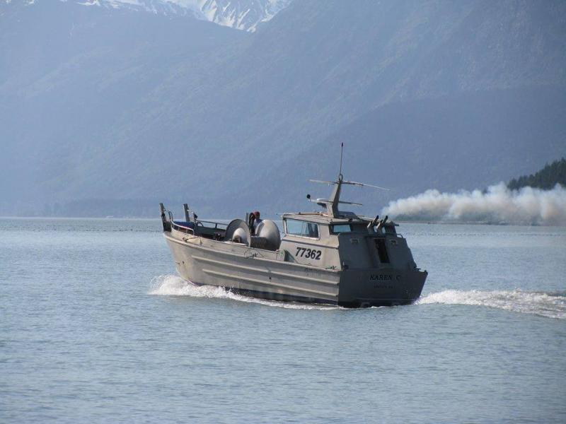

smok1.jpgThis is cold start on a cold day, 100 yards from dock. Rebuilt injectors, clean aftercooler, rebuilt turbos. Engine has good compression.

The first pic is what I want to get rid of, that smoke lasts 4-5 minutes. Less on a hot sunny day. But I also like the idea of replacing everything with a pair of new D4's and drives, except the price :)
