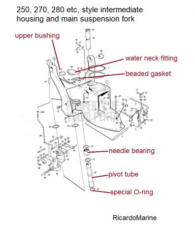

As for the pivot tube and needle I have know idea where that is
See image below.

is that normal or do I have to tear apart the outboard drive and replace the pivot tube and gaskets?
The only gaskets re; the pivot tube would be the special beaded gasket.
The beaded gasket sits between the water neck fitting and the top horizontal portion of the main suspension fork.
The "bead" faces downward and seals against the upper-most portion of the pivot tube.
Remove the transmission ONLY for this work.
There is also an upper bushing that must be in good shape. To replace this bushing, the drive must be taken apart.
There is an over-sized O-ring at the bottom of the pivot tube that seals the pivot tube against the lower gear unit housing. Lower unit must be removed for this replacement.
