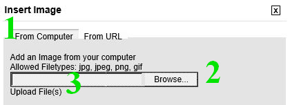

Why not just click the "Insert Image" icon in the toolbar above. That brings up this (without the numbers)........
attachment.php
1 Click on "from computer"
2 Click on "browse" then go to where you store you're pictures on your computer and click the picture so it is entered in the text box (left of the "browse" button)
3 Click on "upload"

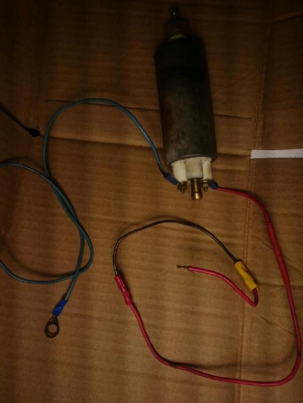

So I went to run the port engine and it wouldnt start. I could hear the pump whirrr, but nothing. a shot of starting fluid and it roared to life and quit. Thought it was a blocked filter which started me down a rabbit hole and I ended up taking everything from the fuel tank to the throttle body out. Not only was the fuel filter downflow of the pump,it was a NAPA filter for a Buick. The fuel pump had 5 wires in total connecting it to the wire harness. and its probably and automotive pump. It all looked like it was plumbed in nice and neat, but holy crap was a mess. So I have to redo from the tank to the engine.
I couldnt find the fuel delivery diagram referenced. but I'm pretty sure its going to be: from the tank to spin on filter-from spin on filter to inline pump- from inline pump to regulator- from regulator to throttle body- from throttle body return to fuel cooler- from fuel cooler to spin on filter. All components with marine certified parts and braided hose.
Am I missing something here?
