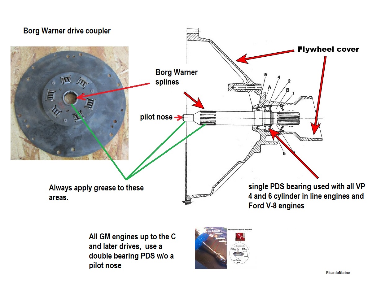

I just purchased an 85 bayliner capri . the engine is seized so I'm pulling it for rebuild. I have removed all the accessories, starter and all the bolts from the bell housing but the engine will not come out. do I have to remove the back side of the bell housing (small end) from the outdrive? any tips or tricks will help. also I have everything disconnected so the outdrive is in the up position.
